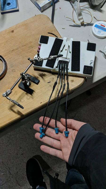

Originally Posted by Nickco43 View Post
I made it work.
Can anyone explain why are connectors made iso use the shark fin which comes with the atm module?
Does the atm module has to be mounted in a special direction?
      10-31-2023, 04:43 PM   #423

The picture Nickco43 posted he made 4 connectors. I want to know why he didn't use the sharkfin which goes with the atm.
Also does the atm has a mandatory installation position or can you just install it on its side?
There are two different types of ATMs for this retrofit, there is one that lives in the trunk and has external connections to the arial (found in convertibles and i'm sure others) and one attaches to the roof with an integrated shark fin (what Nick is using). The roof modules are far more common but that module does not physically fit into an e-series car roof. So you can either try what i did which is leave the shark fin attached and find a place to secure the ATM module (mine lives in inside the rear left fender, there is access from inside the trunk behind the trunk liner), but my GPS signal isn't that great. So you either have to mount it on the back deck in the rear window with good line of sight to satellites (that works but looks trashy and can't hide the wires easily), get a trunk-style ATM module which are hard to find, or do what Nick did to try and wire up the ATM to the existing arial/sharkfin.
Use a trunk mounted ATM. I was originally just being cheap.
