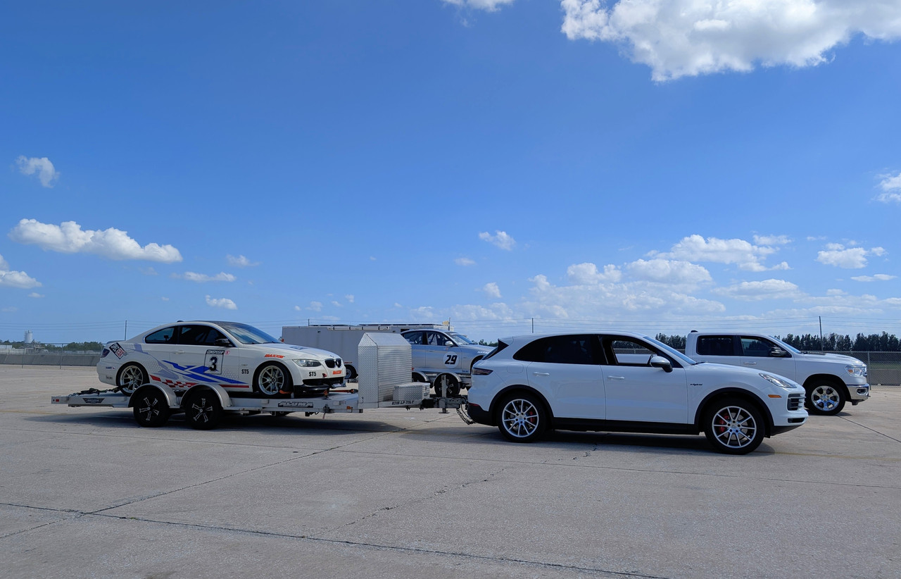

45e/50e have an 8 years or 100,000 miles warranty on the battery.
DIY oil changes/brakes/filters/fluids/etc are all the same as a normal X5 variant very small differences.
PHEV makes a lot of sense for my type of driving (WFH, tows race car several times a year).
I went with the Cayenne PHEV over the X5e, they are very similar and both use the same ZF 8hp transmission with the electric motor in the bell housing. The way ZF designed the system is pretty brilliant imo, it doesn't add a lot of complexity.
So far it's been great and is perfect for my usage. Everyone grips at the 20 mile range, but for someone who WFH, it covers most of my normal usage. I've gone almost 2 months without filling up, covered about 500 miles during that time.
The versatility of the X5e and Cayenne PHEV with 7200/7700 lbs towing capability is pretty unmatched imo. The wide range of utility is amazing.
