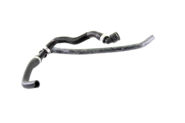

Attaching the hose end to the pump, and the long coolant hose to the flange/nub was super easy, so I did that, surveyed my work and starting filling up fluids! Poured the reserved oil back into the filter housing and threw the filter and cap back on. Reinstalled the expansion tank and added the reserved coolant (just changed it a few months ago, so decided to re-use) and topped off with distilled water and bled the system. No leaks so far!

I just did the upgrade on another car, and wanted to add clarification that all of the above steps are for adding the oil cooler to a car with a manual transmission. If you have an automatic, it's a lot easier as you don't need to swap the metal pipe from the engine. The automatics already have the extra nub that has the line connecting to the bottom of the radiator. You will need to get a new three way connector hose that is specifically for a Z4. It connects to the radiator, engine pipe, and now up to the oil cooler. It is part number 11537526941 which I bought as an aftermarket part from FCP.
They are about $100 from the dealer if you want to go with BMW part.

If you have an AT, adding the oil cooler is a super easy job! You just need the updated oil filter housing that has the cooler, and the three-way coolant hose from a Z4. Maybe an hour job. Call it two to be safe.
