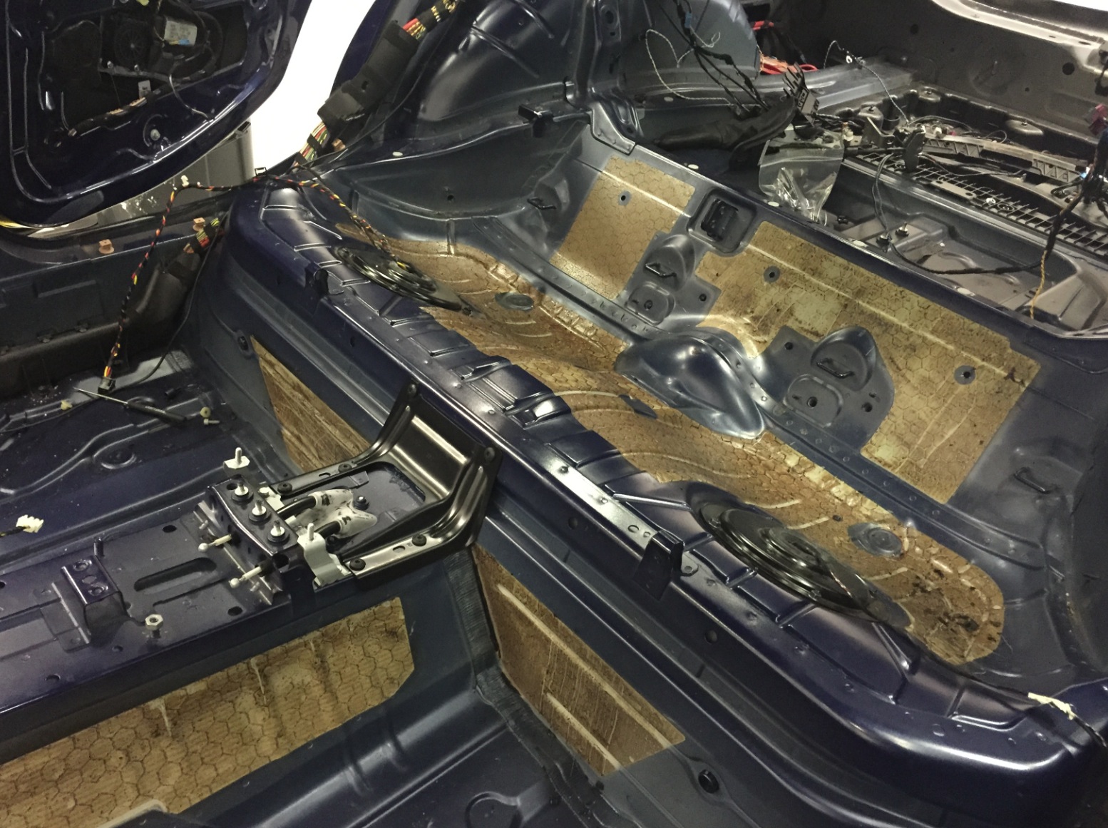

Originally Posted by tetsuo111 View Post
That might be me, Al. I think I brought those rear strut tower M3 side braces to the attention of the community. They are a welcome addition for stiffening the chassis further.
Sorry to beat a dead horse but after wasting a lot of time trying to figure out how to retrofit these shock tower braces to my E90, I found out that the E90 M3 doesn't even have them. Not the best photo but you can see that they are missing and that the bottom mounting hole isn't threaded:
https://www.m3post.com/forums/showthread.php?t=1158445
Another photo with no braces. It also shows sound deadening covering where the mounting holes should be exposed:
https://www.flickr.com/photos/59241080@N03/8555822358/
Since these braces are only found on coupes, I'm guessing the rear door frames provide enough rigidity so that they're not required on sedans. This also suggests that the E90 chassis could be inheritly more rigid.

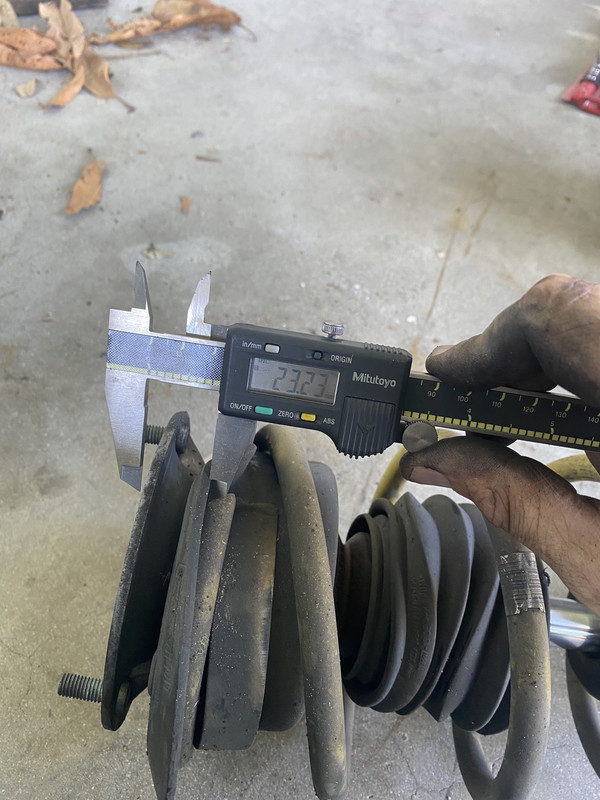

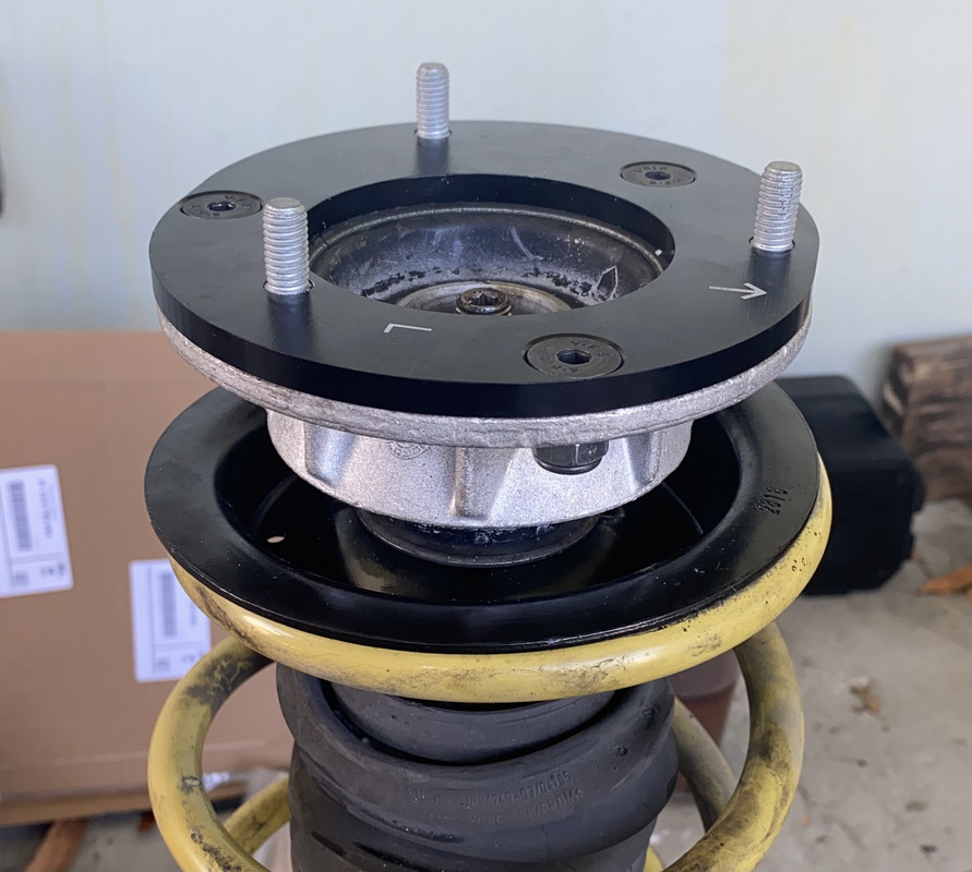

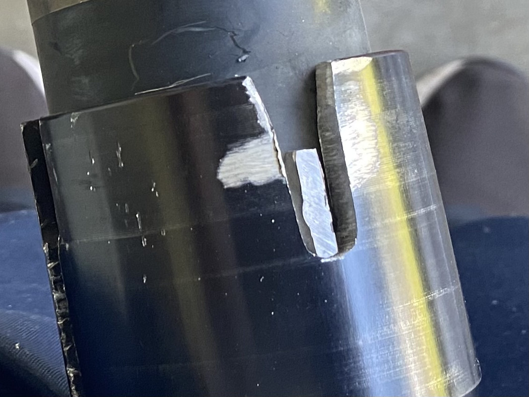

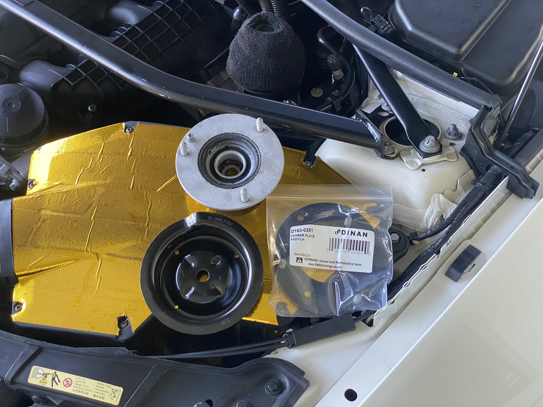

Did a mod today! At my last track day I felt like the car was really dialed in but I noticed some understeer at the limit and the front could use a little more grip. So I wanted to bump my camber from -2.4 to -3.0 which is what a lot of the track focused M3 builds I see are running.
A side benefit is I think a little more camber would allow me to swap from 245/35r18 front tires to 255/35r18 which is would also help under steer and would also match what I have on the rear.
So a little camber added gets me a nice reduction in understeer by 2 mechanisms.
-3.0 is aggressive camber for sure but from the research I did tire wear on these cars should be ok if you have all Uniballs (which I do) and get the toe dialed in. So away we go!
I decided to use the Dinan camber plates to get the camber. I have slotted strut mounts already and with the E92M3 control arms and the M4 spindle was able to achieve -2.4 camber without any plates. So adding the Dinan plates would get me around -3.1.

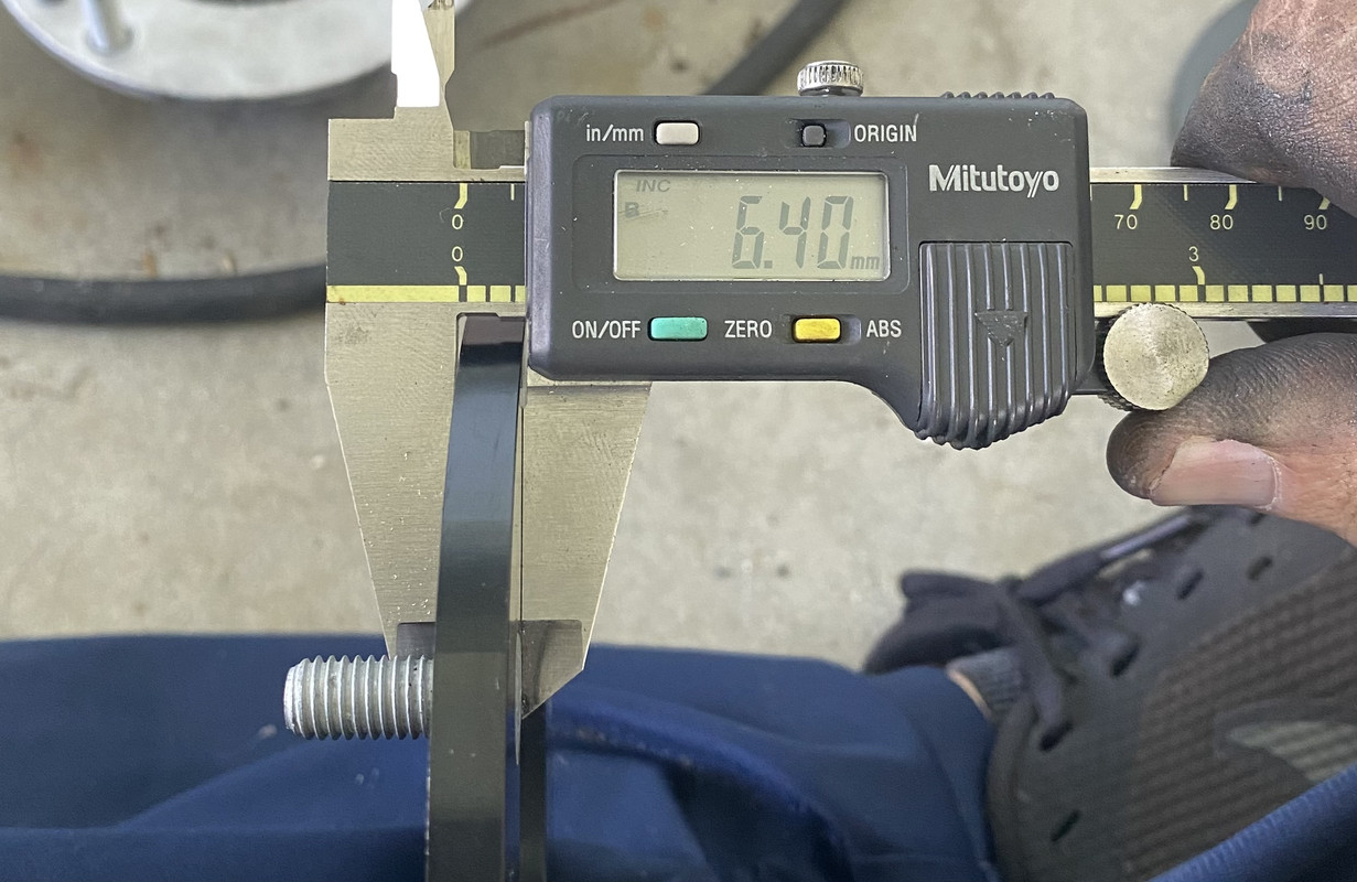

The downside is the added stack height of the Dinan plates:
So that Dinan camber plate would raise the front ride height by ~6mm.
But that’s not all… On top of that, the Dinan plates don’t play nice with the SRP front drop perches I have installed because the Dinan mounting bolts rub the top of the drop perches under load and can make the steering lock up. So I had to deal with also raising the front ride height an additional 15mm (on top of the 6mm from the Dinan plates) because I had to take off the drop perches and swap to normal spring perches.

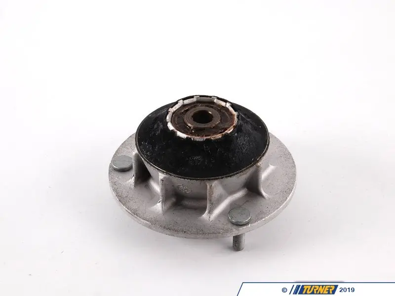

I decided to use the X Drive strut mounts instead of the OEM sport mounts. Those take away a little ride height, maybe 4mm, because they are shorter than RWD strut mounts.
After assembling the new stack on top of a strut I took some measurements and found the new assembly would still leave 17mm of ride height to compensate for even with the X Drive strut mounts:
I decided to just sink the strut 17mm deeper into the Spindle (Steering Knuckle) by cutting a V in the strut adapter I’m running and it worked perfectly.
So the car is now sitting same ride height and aligned to:
-3.0 front camber
-2.0 rear camber
Best of all now I can get some wider front tires… and also in any brand I want! There were only 2 tires that came in the 245/35r18, the Michelin PS4S and Falken FK510. After a bunch of searching I found none of the decent more track/performance oriented tires came in that size.
So now that I can go to a 255/35r18 front I can pretty much run any tire because they all seem to come in that size.

Good stuff. Interesting that the xdrive mounts are reinforced too. How are the gussets oriented? ie transverse or longitudinal?
Biginboca3864.50
      07-03-2021, 07:26 PM   #765
Biginboca
Biginboca's Avatar
3865
2,739
Drives: 2009 E92 328i 6MT
Join Date: Jun 2017
Location: Boynton Beach, FL... USA
Both I guess lol

So after doing some reading last night it’s come to my attention that I can likely fit 265’s up front with this new spec. Looking at the car there is definitely quite a bit of room this is from this morning with the 245’s up front…
Not sure I need 265’s. In the PS4S I was shopping for my next set of tires they are 2lbs heavier than the 255’s.
Although there is definitely some allure to running 265’s square on a e92 haha
Here’s a pic to show how the ride height ended up with the modified strut collar:

Originally Posted by Tambohamilton View Post
Here's my source on strut mount info:
https://www.e90-forum.de/forum/threa...er#post1510042
Just out of interest, why have you (seemingly) aimed for the same fender gap front and rear, rather than any other measure of ride height?
Also what top spring perch is that you've used?
I’m now running the standard e9x front spring perch (p/n 31336759452) which gives plenty of clearance for the Dinan Camber Plates nuts.
As far as ride height, it’s actually not ideal for what I want. I’d actually like to run the car flat to maybe even a bit of negative rake. I know shirmer likes the cars set up like this, and I have been taking a lot of cues from their builds this year.
I will say I like the front height where it is because #daily but the rear about ~10mm lower would be fine by me. From what I have researched these cars seem to handle best with zero to slight negative rake.
It arrived where it is now because the rake increased a bit after weight reduction because more of the weight loss was from the rear (lithium battery took 45lbs off the rear and rear seat delete took 40lbs off the rear). Most of the other mods were even reductions front to rear.
I cut the rear springs a bit when I did the rear uniballs and that seemed to get me back to about factory rake. At this point without doing coilovers (which I don’t really want to do yet) only way I know to take the rear down a bit more is cut the springs a little more, which I would prefer not to do because this increases the spring rate, or maybe try some of those adjustable rear springs/perches. I need to check the spring rates on those but I might be doing that next if they are in the 500-550 lb/inch range.
