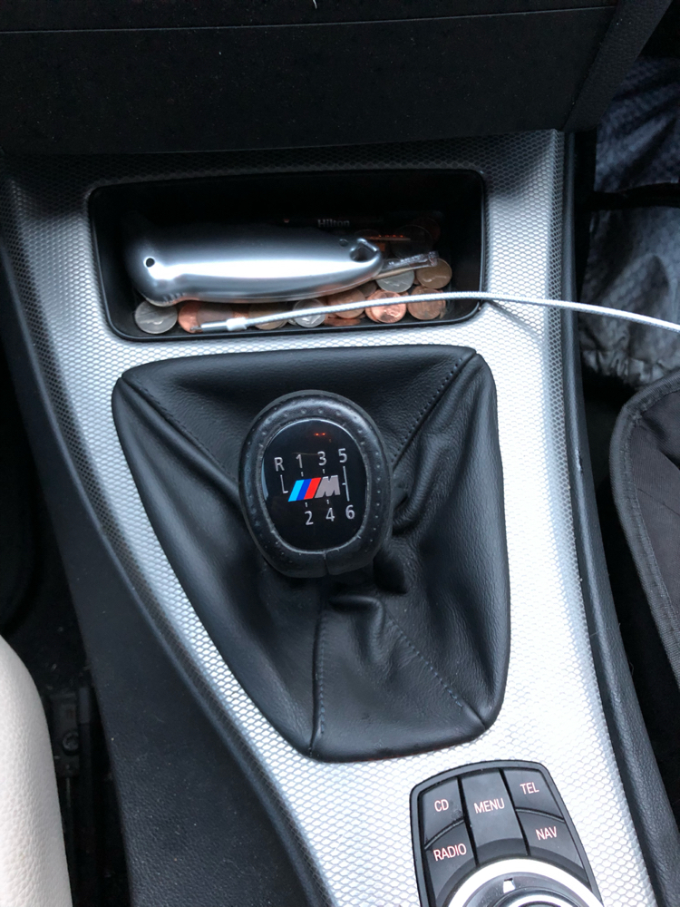

No it's just the way it sits. I think there's another thread that mentioned the same thing. The Dinan instructions also state to insert the lever with the bend pointed towards the rear left. So slightly angled to the left.

Very subtle
