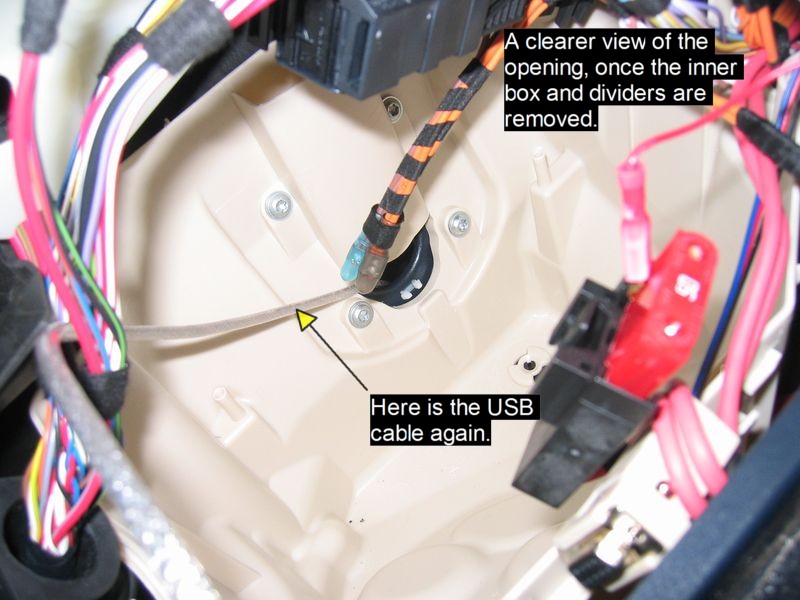

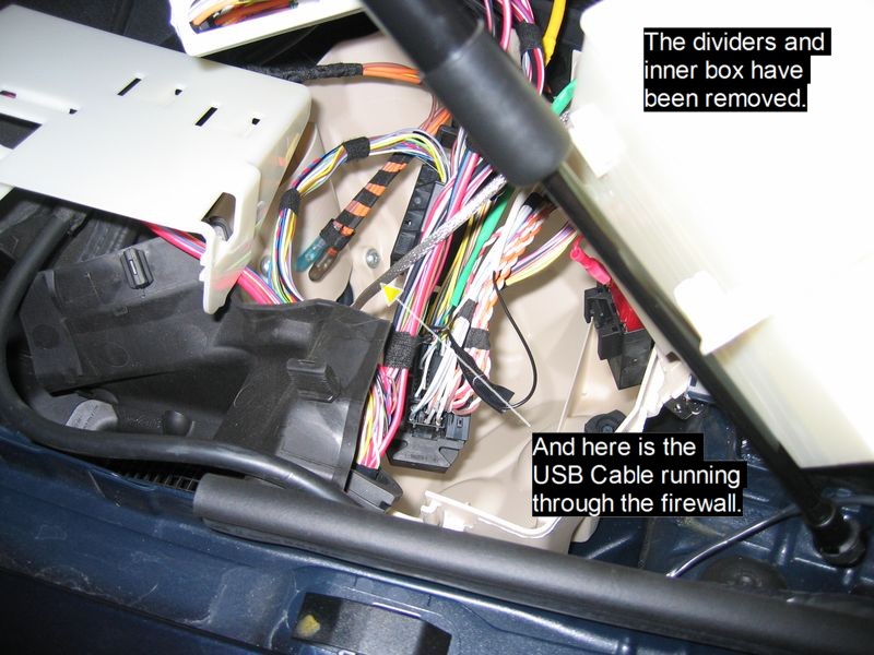

Hope these pictures help you. (Ignore comments on pictures, as I pulled this from another thread)

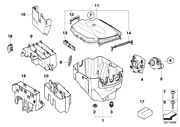

Remove all the plastic sections inside the box and look against the firewall side for the 4 Torx screws (part #7)......you'll notice these in one of the pictures below. These seem to be holding the fan unit shroud assembly. Undo these cautiously, as I believe they hold the ventilation cover (shroud) and the fan assembly located through the hole in the firewall, just behind it.
Also looks like there is a Water Outlet Valve (part #2) and a rubber stop buffer (part #3) located at the base of box that is press fit to hold the box down......just pull up on the whole box, to release it.

Does anyone know if that slot where the USB passes through interferes with the ECU fan? I thought that slot was for some ductwork for that fan
