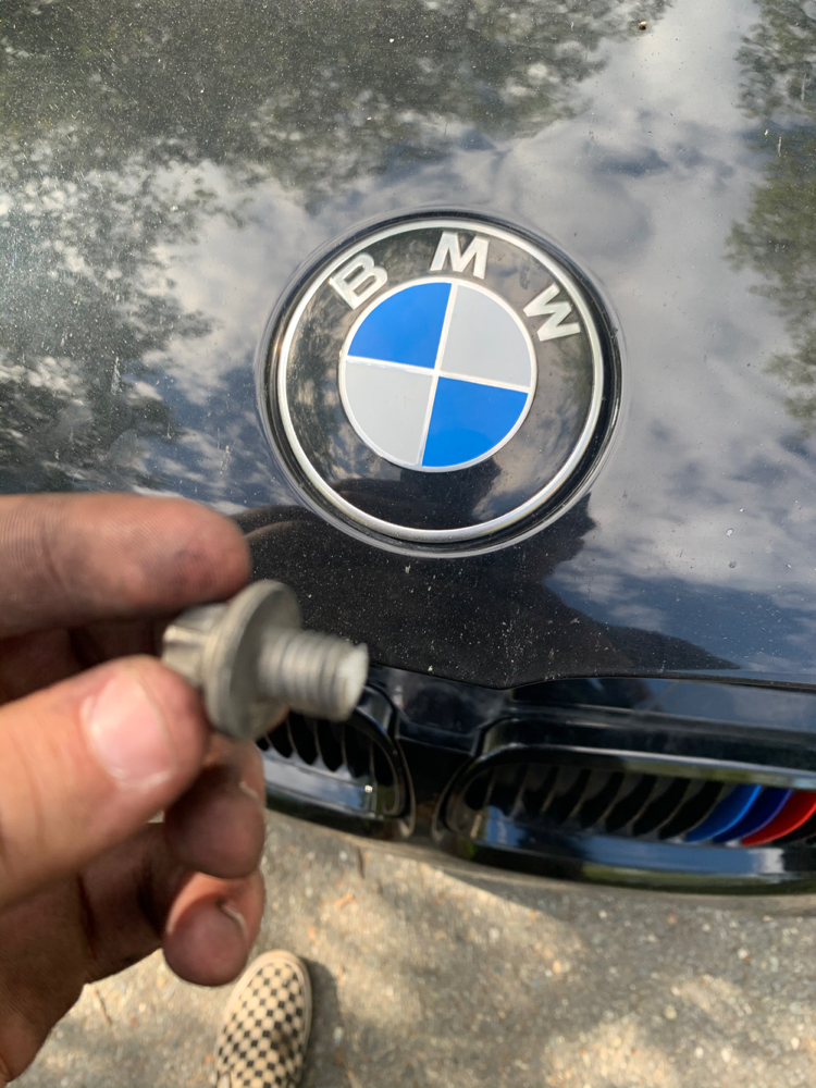

As I was removing the starter on my 07 328i the bottom bolt head snapped off any ideas on the easiest way to get the rest out? Also what is everyone using to get to the back one? I already removed the one in the back but it wasn't easy.

You need an Irwin spline kit.
IRWIN Screw Extractor Set, Hex Head, Multi-Spline, 25-Piece (53227) https://www.amazon.com/dp/B0002SRG66..._pjSHEbEFQZG31
It's a lifesaver
