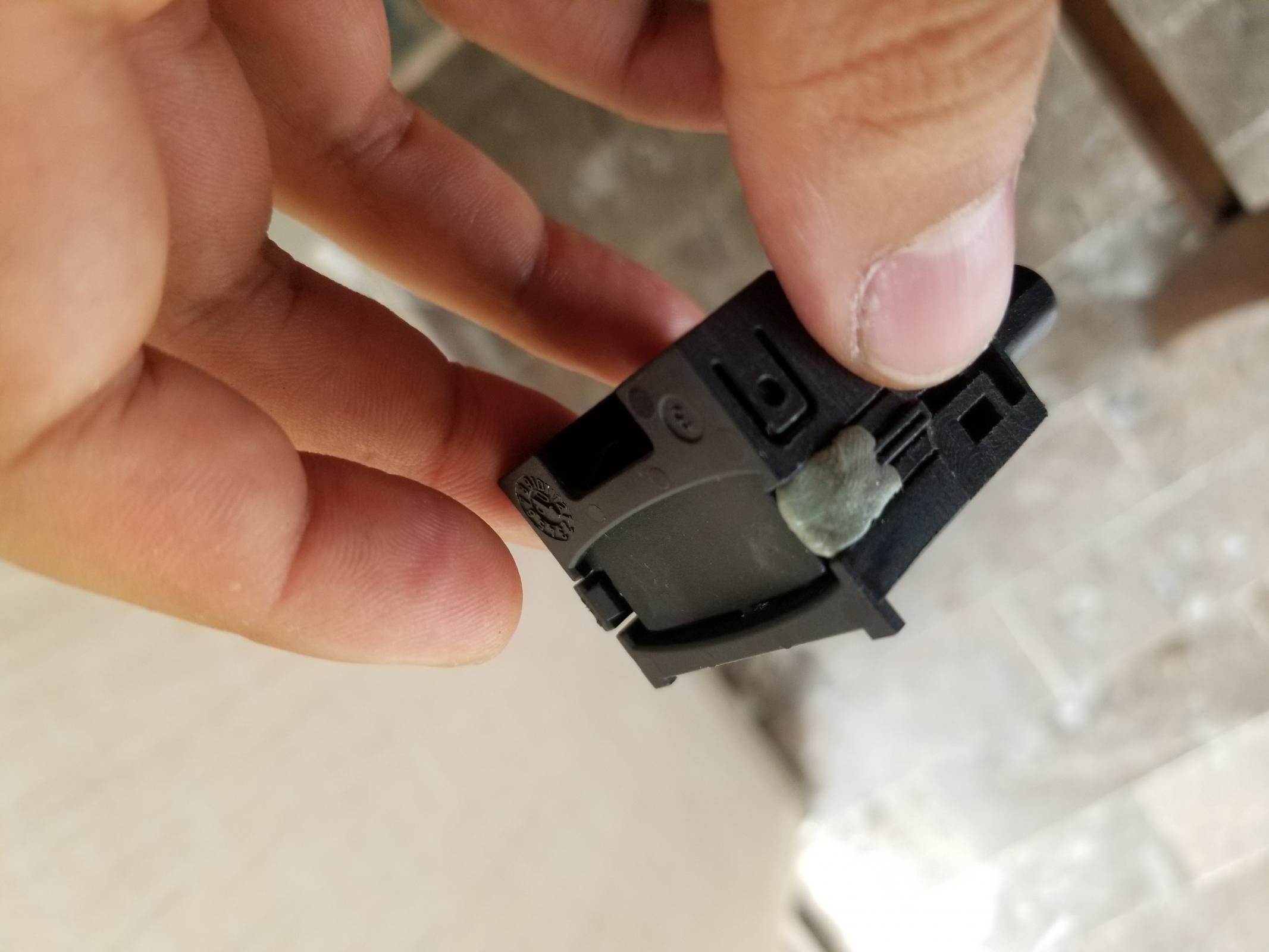

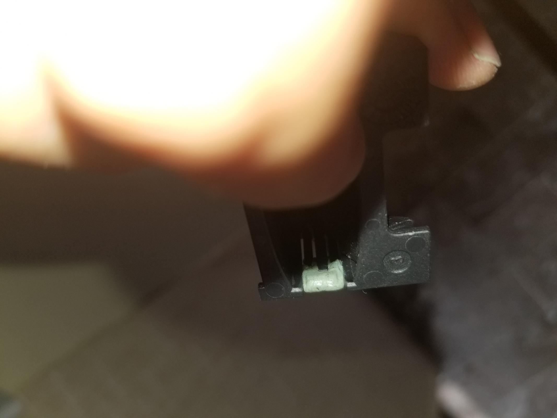

So in my car the key lock was broken, this lead to the key falling on bumpy roads or in corners. I decided to remove the key lock and investigate and it turned out that a small leg or clip from inside the module was broken. I decided to use some epoxy clay to try to simulate the function of said broken part.
I am trying to do as many diy because I am currently locked down in quarantine
Hope this diy can some day help someone

15 pounds sounds great, in my country I couldn't find the replacement part. As an update, this has worked just fine. Same as new
