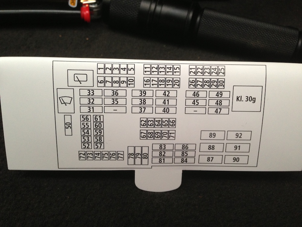

For more on the terminals and which drive what components, I attached a PDF that contains most of this info.
So the challenge is: power the outlets from Terminal 30g instead of from Terminal 15. Challenge accepted!

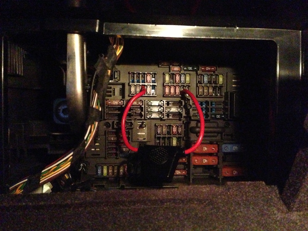

The plan: Open up the fuse box. Splice the accessory-side of the outlet fuse into some empty socket connected to 30g.

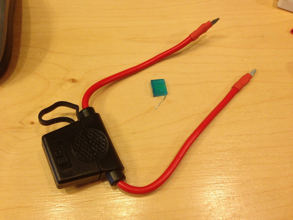

Initially, I just cut up a donor fuse and soldered the leads of an external fuse holder to the two legs. This worked ideally, but was too loose - I felt like a hard turn or speed bump might pop it out. Loose electrical leads aren't good. Pictures below.

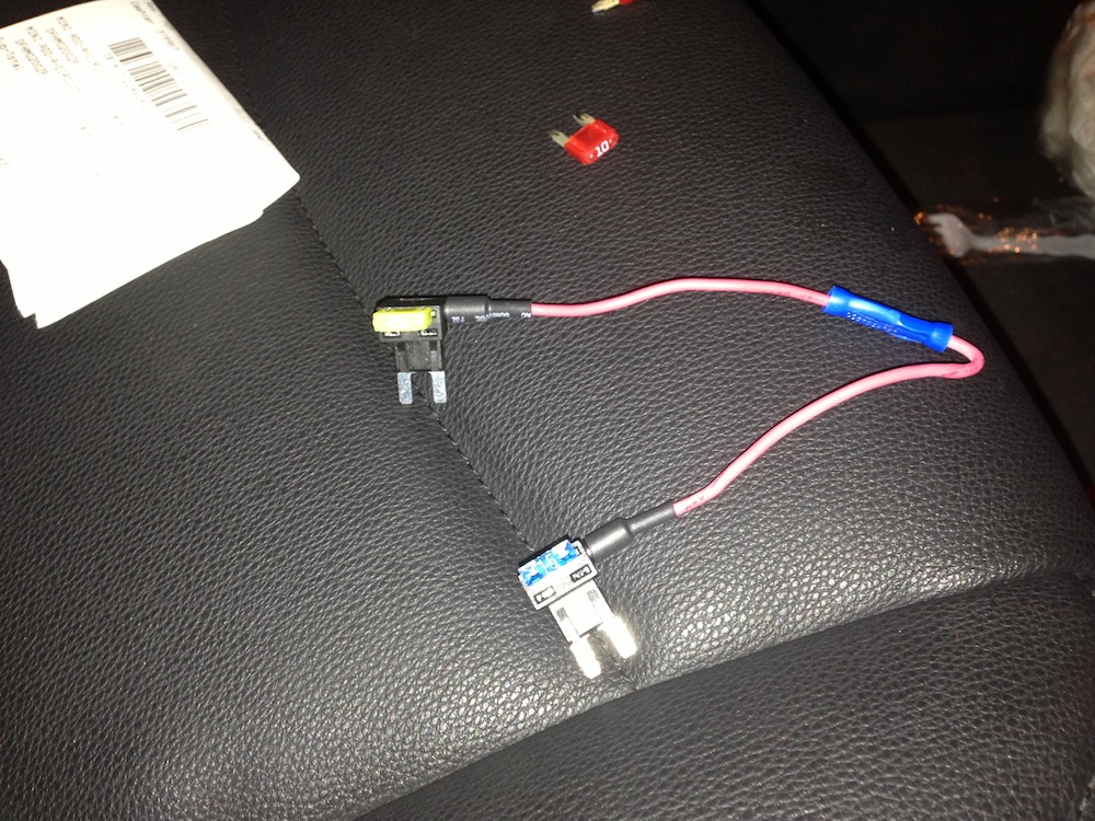

The solution was to get a pair of fuse taps. The internal construction is such that the output lead is fused to the far-side terminal via the top fuse slot. This is great - I'd just connect the two taps together, put 20A fuses in the top (the socket circuit is fused for 20A stock), and wire them in such that the live side of one is plugged into the socket circuit output, and the live side of the other is plugged into the terminal side of some unpopulated accessory running from T30g. Warning. These fuse taps are only rated for 10A, and I intend to fuse them at 20. I'm not too worried, but if you regularly use your sockets at full-capacity, I'd be careful about this. Also, in this configuration, I'm diverting ALL of the potential 20A OFF the T15 relay and ONTO the T30g relay - it'd be smarter to use T30g to drive a relay that supplies power to the sockets from T30 or something, but again, screw it, it's probably fine. But if you blow a T30g relay, this is probably why (luckily, it's replaceable).

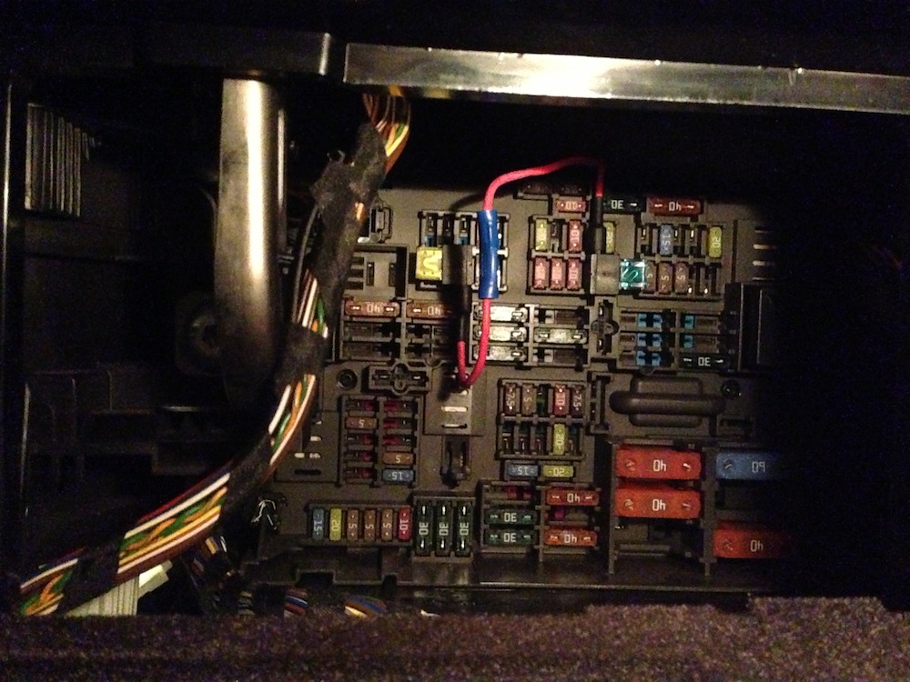

Note in the picture there's one 20A fuse and one 15A - unfortunately, I don't happen to have a 20A fuse handy (the one in there is the original), so the sockets are fused at 15A for now. Note that ALL sockets (well, at least the armrest and under-dash) are on this one fuse, so the 20A is total across all sockets.

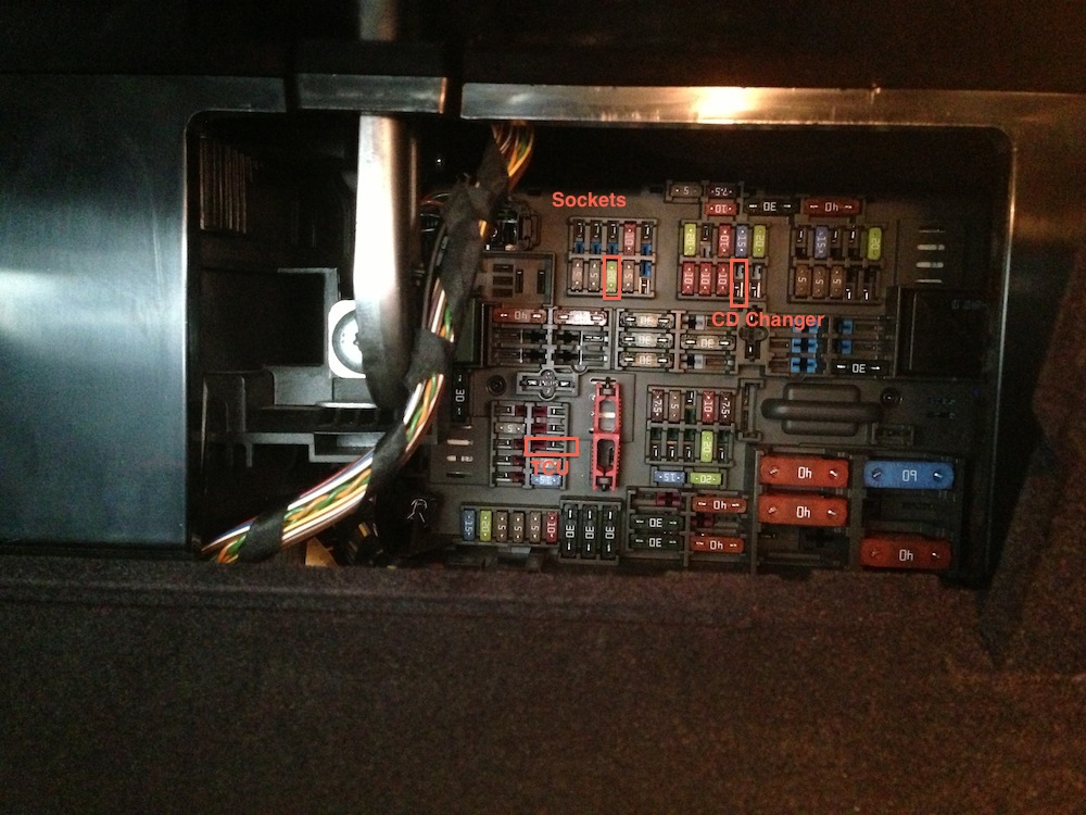

Well, I don't have a CD changer and don't plan to get one, and that accessory happens to be on terminal 30g, so that's a perfect donor slot. Initially, I tried to use the empty TCU fuse slot. Well, this is when I found out that US-spec TCUs are always on (connected to T30). Something good to keep in mind if you ever want to hard wire an always-on accessory. Although I'd probably use T30g-f if I were going to wire something always-on (like maybe a dash cam). Reason being, any accessory that's always-on is going to significantly impact the 22mA constant draw the car expects. And the car throws a parasitic draw code at 80mA draw in sleep, which is a really easy limit to hit. At least connected to 30g-f, you won't ever drain the battery to the point the car won't start.
Note that, in all the fuse slots, one side is the gray plastic housing, and one side is a colored insert. The gray housing is the terminal side (so always live), and the colored side is the accessory side (unpowered with no fuse present or if a fuse is broken).
And the final setup!

I know this is a little old but I am thinking of doing this for my dash cam. I am trying to figure out how these add-a-circuit taps work. I am concerned that your method will make the entire Terminal 15 bus hot with the power from the tap on the Terminal 30g bus. Your first method seems like the right way to do this properly and ensure that you don't energize the entire Terminal 15 bus with the tap.
      07-25-2013, 11:34 AM   #3
alexwhittemore
123
1,951
Drives: 2009 Crimson 328i
Join Date: Oct 2012
Location: Los Angeles
The taps only tap ONE SIDE of the connection, with a fuse between the tapped pin and the wire. The first and second methods are electrically equivalent in that T30 is supplied to the ACCESSORY side of the lighter socket fuse, BUT NOT the T15 side.

I get it now. So it does become important which direction you put the add-a-circuit plug in as well. This could be quite useful. I will have to experiment. I have been looking for a way to extend the length of time my dash cam stays on while I am parked.
      07-25-2013, 05:56 PM   #5
alexwhittemore
123
1,951
Join Date: Oct 2012
Yep! And actually, they don't really make it clear, but orientation of the tap sort of always matters: if you have the tap in backwards, current for the accessory flows first through the original accessory fuse (bottom of the tap) THEN through the new accessory fuse, then out the wire. It's easy enough to get right: the bus side of the fuse tap is opposite the wire (so current flows through the top fuse), and the bus side in the fuse holder will be powered, while the accessory side won't be. In the BMW fuse box, where fuses are ganged up in two rows, the bus side is the outside of the row and the accessory side is inside. Note above, the outside of the CD changer is connected to the inside of the lighter socket fuse.
